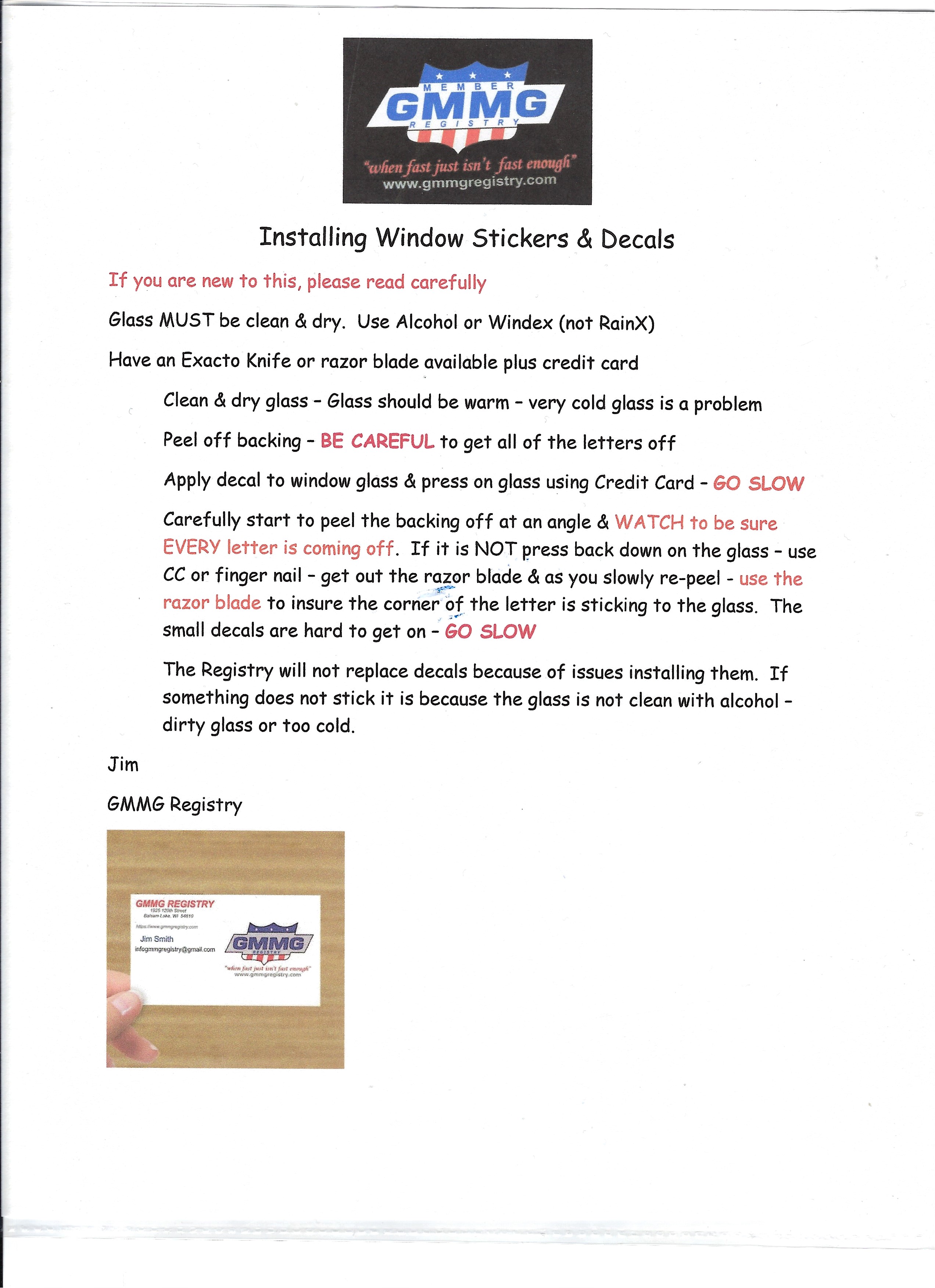

If you are new to this please read carefully.
Glass MUST be clean & dry. Use Alcohol or Windex (not Rain X)
Have an Exacto Knife or razor blade available plus a Credit Card
• Clean & dry glass
• Peel off backing – BE CAREFUL to get all the letters off – use razor blade – Peel at an angle - GO SL
• Apply decal to window glass & press on glass using Credit Card or finger nail – go over it a number of times.
• Carefully start to peel the backing off at an angle & WATCH to be sure EVERY letter is coming off. If it is NOT press back down on the glass – use CC or finger nail – get out the razor blade & as you slowly re-peel use the razor blade to insure the corner of the letter is sticking on the glass. The real small decals are hard to get on – GO SLOW.
The Registry will not replace decals because of issues installing them. If something does not stick it is because the installer is not doing things right – in a hurry or dirty glass surface or letters sticking to the backing when peeling off.
