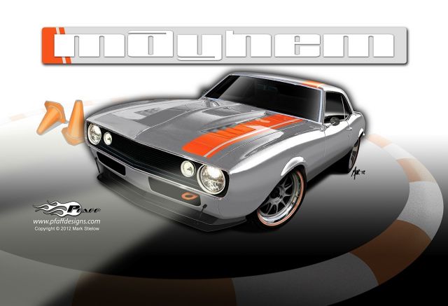

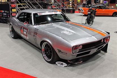

Mark has been working with Brian Thompson at Thompson Automotive in Wixom, Michigan, for his last few engine builds. For “Mayhem,” his silver 1967 Camaro, the LS7/LS9 hybrid combo was tweaked. They added CNC-ported heads and a new cam that moved the torque band up. Since the car was traction-limited by the tire size, the idea was to keep the same max torque and instead increase power through a higher engine speed to help acceleration without overpowering the tires. That engine was dyno tested at 877 flywheel horsepower and 820 lb-ft of torque. Thanks to the “arms race,” Mark felt that even more power was necessary for his next build.

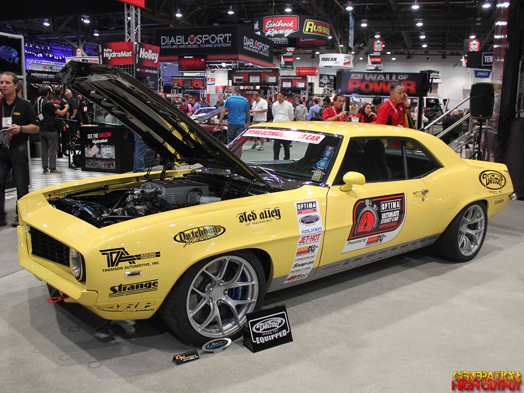

“Hellfire” uses an LS7 block with a Callies crank, Diamond pistons, and Oliver rods, assembled with ARP hardware. Its high-rpm longevity is possible thanks to titanium intake valves and retainers in its CNC-ported heads and oil squirters pulling combustion heat from the bottom of the pistons. The engine relies on the factory dry-sump oil pump with added tank capacity and an efficient oil cooler from C&R Racing.
When strapped to an engine dyno, Hellfire’s hybrid LS7/LS9 engine produced more than 800 lb-ft of torque between 2,500 and 6,200 rpm, with power holding more than 950 hp from 6,100 to 6,600 rpm. That level of power would be unheard of in a Pro Touring car just a few years ago.

Mayhem used a stock GM ABS system and a modified calibration to work as standalone ABS. Mark likened it to using software on a factory ECU to tweak the fuel and spark. There’s some leeway, but it has a narrow window where it likes to work. Factory ABS is tuned to prevent wheel lockup, although it can be tuned to put more energy into the brakes and lower stopping distances, which can be a big benefit to track cars. Because of that, Mark’s later builds use a Bosch motorsports ABS system that allows for more involved tuning of the braking system. It’s like using an aftermarket ECU and a laptop tuner—but for brakes. Like an engine, Mark noted, “Just because it’s running doesn’t mean it’s running right. ABS is the same way.” Even if a car seemingly has all of the parts needed to run late-model ABS, it doesn’t mean it’s going to be optimized. When it’s operated without all the sensors it’s looking for, the ABS system will go into a backup calibration that’s not as efficient, so if ABS is in your future, make sure the ABS is getting all of the required information.

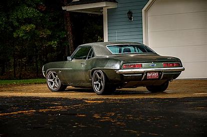

Jackass
2009 – LS9 custom tuning: 700 hp.

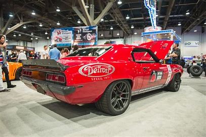

Red Devil
2010 – 7.0L LS9: 810 hp.
Mayhem
2012 – 7.0L LS9 CNC ported heads, new cam: 875 hp.- Refresh 2019-2020
Hellfire
2014 – 7.0L LS9 CNC ported heads new cam, blue-printed blower: 953 hp.
Jackass 2.0
2015 – 7.0L LS9 CNC ported heads new cam, blue-printed blower, E85: 970 hp.
MAYHEM
